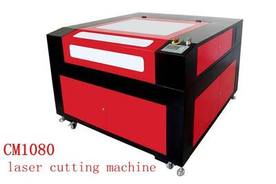

Redsail CM1080 Laser Cutter
Everybody loves lasers
Status OPERATIONAL as of April 9, 2024
Training YES (see below)
Owner Vancouver Hack Space
If it Breaks Turn off. Put a BROKEN sign on machine. Notify forums and Laser Cutter Committee immediately.
Loan Status Owned by VHS
Arrival Date March 30, 2012
Location Back of VHS
Value $3500 + ~$1000 to get it here and set up

  • Bed size: 1020mm x 820mm
    • Total work area size: 1000mm x 800mm
    • Honeycomb grid (small): 630mm x 470mm x 20mm high
    • Honeycomb grid (large): 900mm x 600mm x 20mm high
  • Type: CO2
  • Power: 80W
  • Controller: Ruida 6445 (replacement installed in 2023)
  • Power supply: LSR-JN80WCO2-2V
    • Input: AC 220V
    • Power: 80Watt, 100Watt peak
    • Triggering Voltage: 28KV
    • Operating Voltage: 22KV
    • Current: 32mA max
    • 3pin terminal pinout: G, AC, AC
    • 6pin terminal pinout: H, L, WP, G, IN, 5V
  • 3-Phase Stepper Motor Drivers: Cloudray 3DM580S or Moons 3SR8H
    • Note: Different driver models have different pinouts even though the connectors are the same. DO NOT swap connectors without changing the wire order.
    • Input: DC 40V
    • Motor current: 4A
    • Steps/rev: 5000
    • Idle current: half
    • Power-on self test: off
