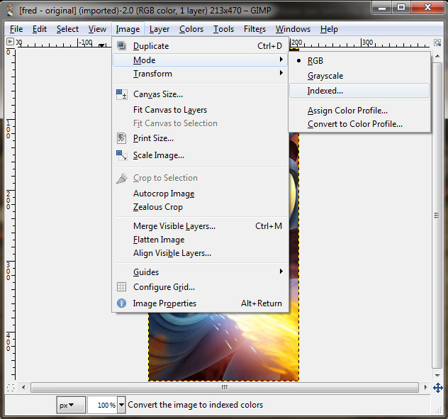

Once you are ready to move on, we get to the fun part. Getting just the right settings for this step might take some experimentation so I am going to include images of my tests as we go. Click on Image > Mode > Indexed

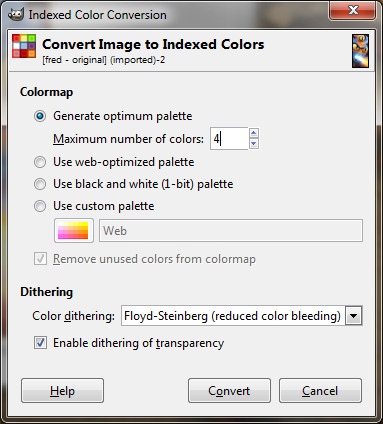

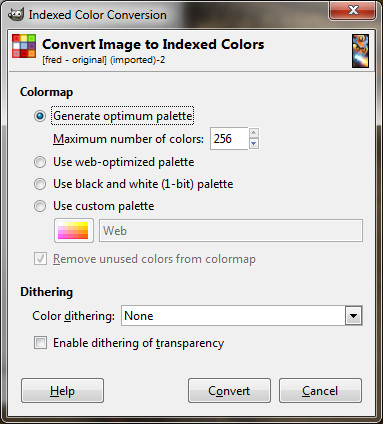

You will get a popup that looks like this:
I will give examples later of what the various settings look like, but for now, I suggest starting with maximum of 4 colors and enabling the Floyd-Steinberg dithering like so:

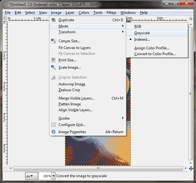

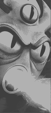

The next step is to convert that to a greyscale image that the laser can use by going to Image > Mode > Greyscale
Your image should now look like this. Export it as a jpg and it will be ready to import into LaserCAD!

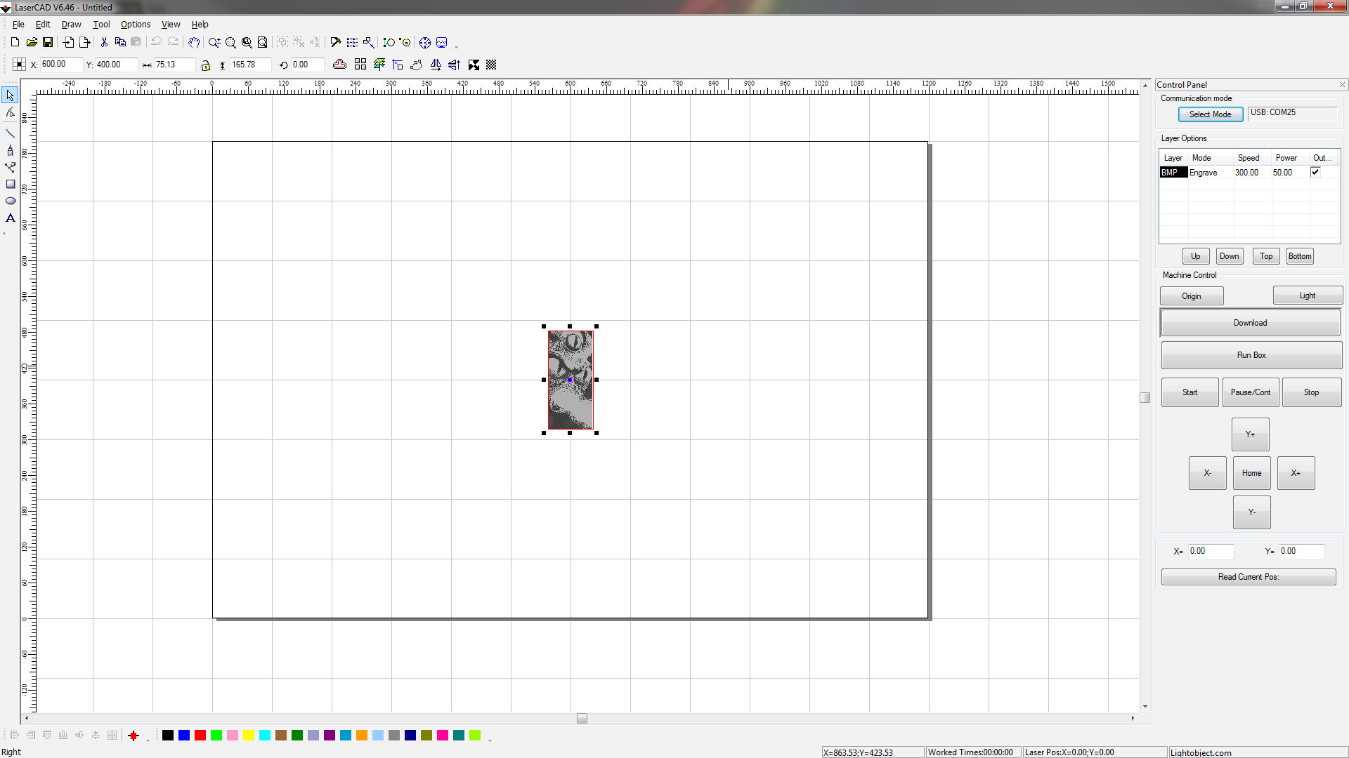

This part is surprisingly easy once the artwork is prepped correctly. Open LaserCAD and import the jpg image:
It will look horrible and distorted, trust in the force.

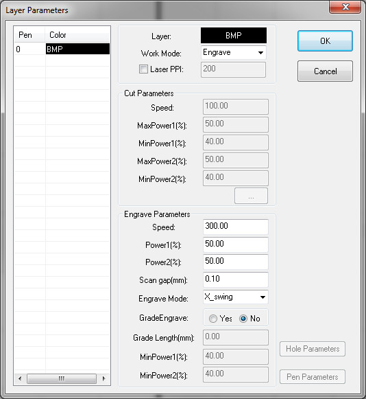

Things to note are that where you normally see a color swatch on the “Layer Options” section where you pick your power settings, you now have a row for “BMP” with the mode set to “Engrave”.
Double click on there to open your Layer Parameters menu where you will set your power and speed:
The advanced section will go into detail on how I came up with these settings but for this project change the speed to 200, power1 and power2 to 30, and scan gap to 0.05 and click OK.

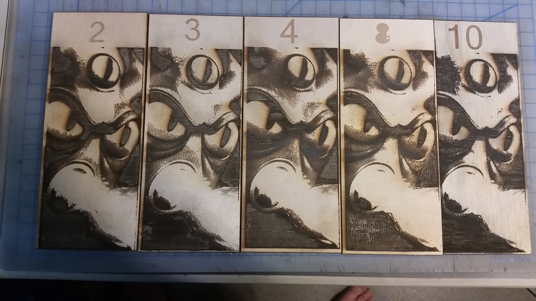

Starting with the original color image, I went through the steps above to convert and save the file using various index settings starting at 2 colors all the way up to 20. Each of these was indexed, dithered, greytoned, imported into Lasercad and individually run using identical power and speed settings, and cut out onto a tile with the index number etched onto the tile along with the image. When I lined them up, I picked which one I thought had the most detail.
I personally decided that the jump from 4 to 8 seemed to be a step down in quality so I ran it at 10 to make sure it wasn't an anomaly. I still liked the detail in 4 better than 10 so I didn't bother running anything higher than that.

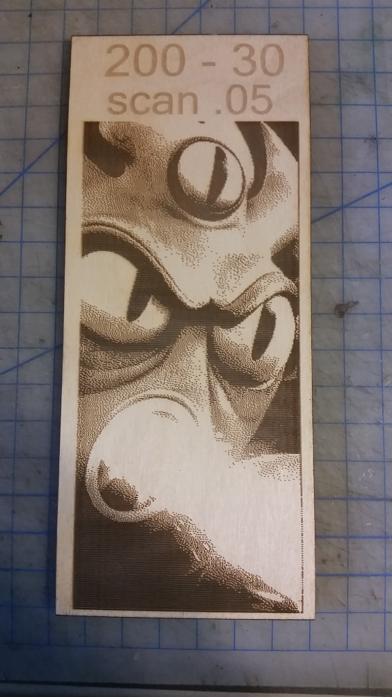

Power 50 cut clear through the top layer of the plywood and left ugly gaps, the 20 vs 30 I suppose is a matter of personal preference. I picked power 200, speed 30 since I think it had the best contrast and detail.

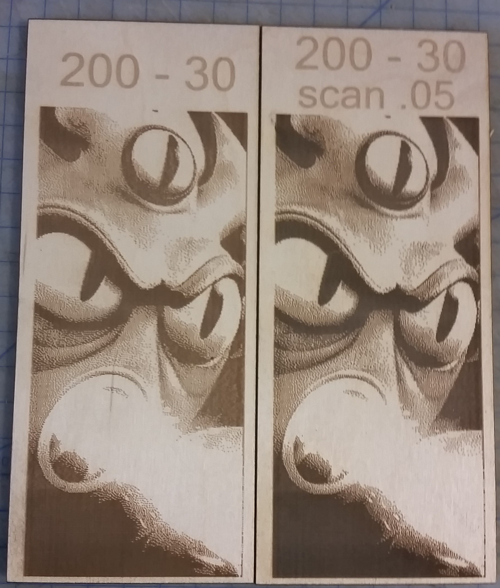

From there, I ran the one I liked the best so far [index 4, power 200, speed 30] again, but with half of the line scan [changed from .1 to .05]. This doubled the etch time so it may or may not be worthwhile, depending on your project. Here is a side by side of the results:
The difference is definitely noticeable, but I'll let you decide if it is enough of a difference to double your cut time.
