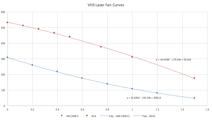

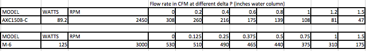

For an 80W CO2 laser such as that of VHS, the suggested minimum flow rate is 250cfm. In order to meet these requirements, a target setpoint of 350cfm was used. To meet this spec, two axial fans original designed for hydroponic applications were investigated. The fan curves are below:

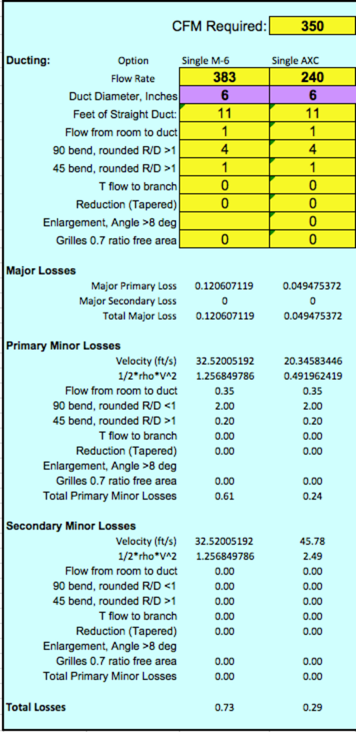

Given the 6' ducting, and required filters, the major and minor Dp's were calculated and compared to the available fan curves. This determined that the optimum setup was a single M6 fan with minimal other backpressure as seen below:

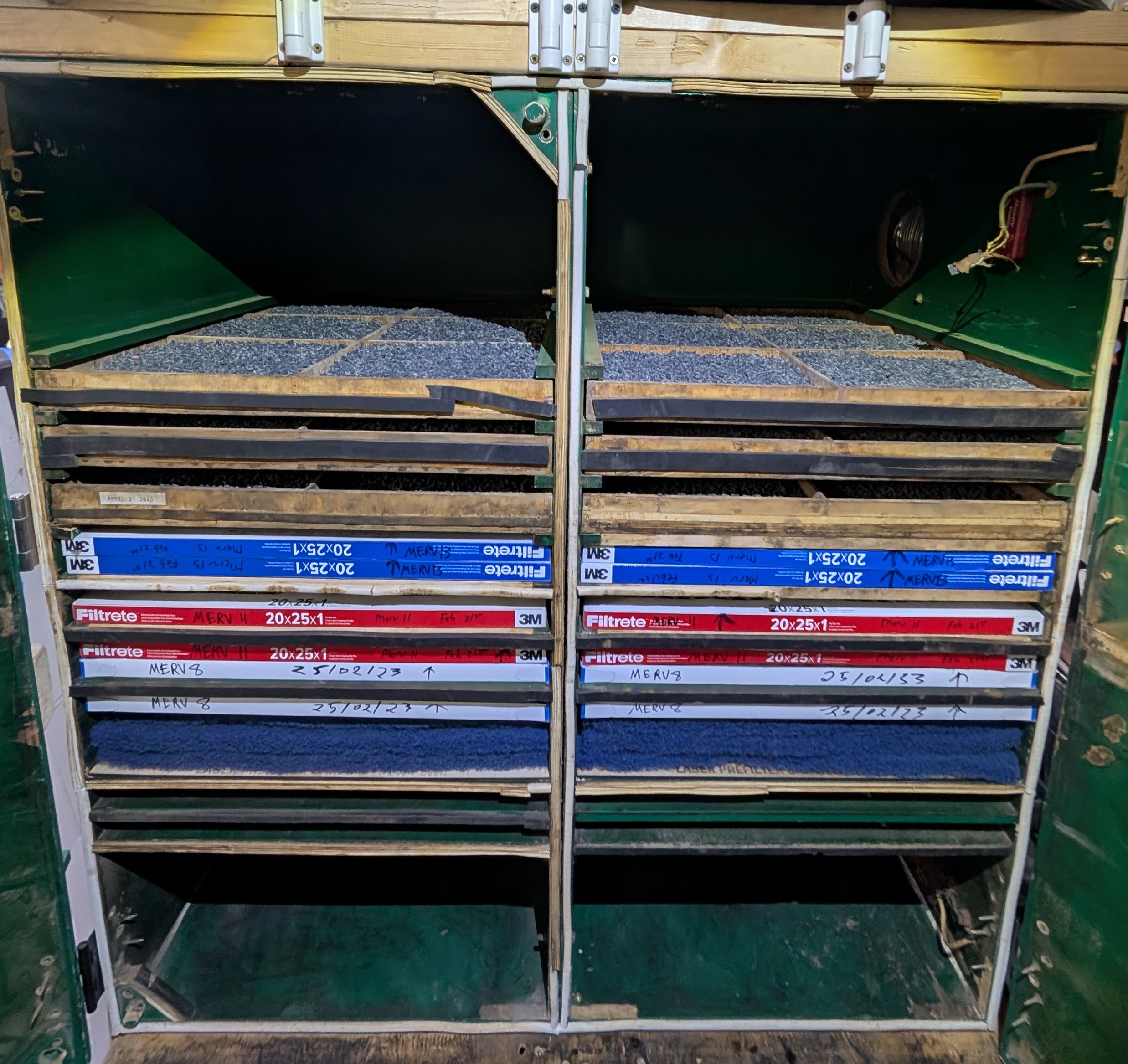

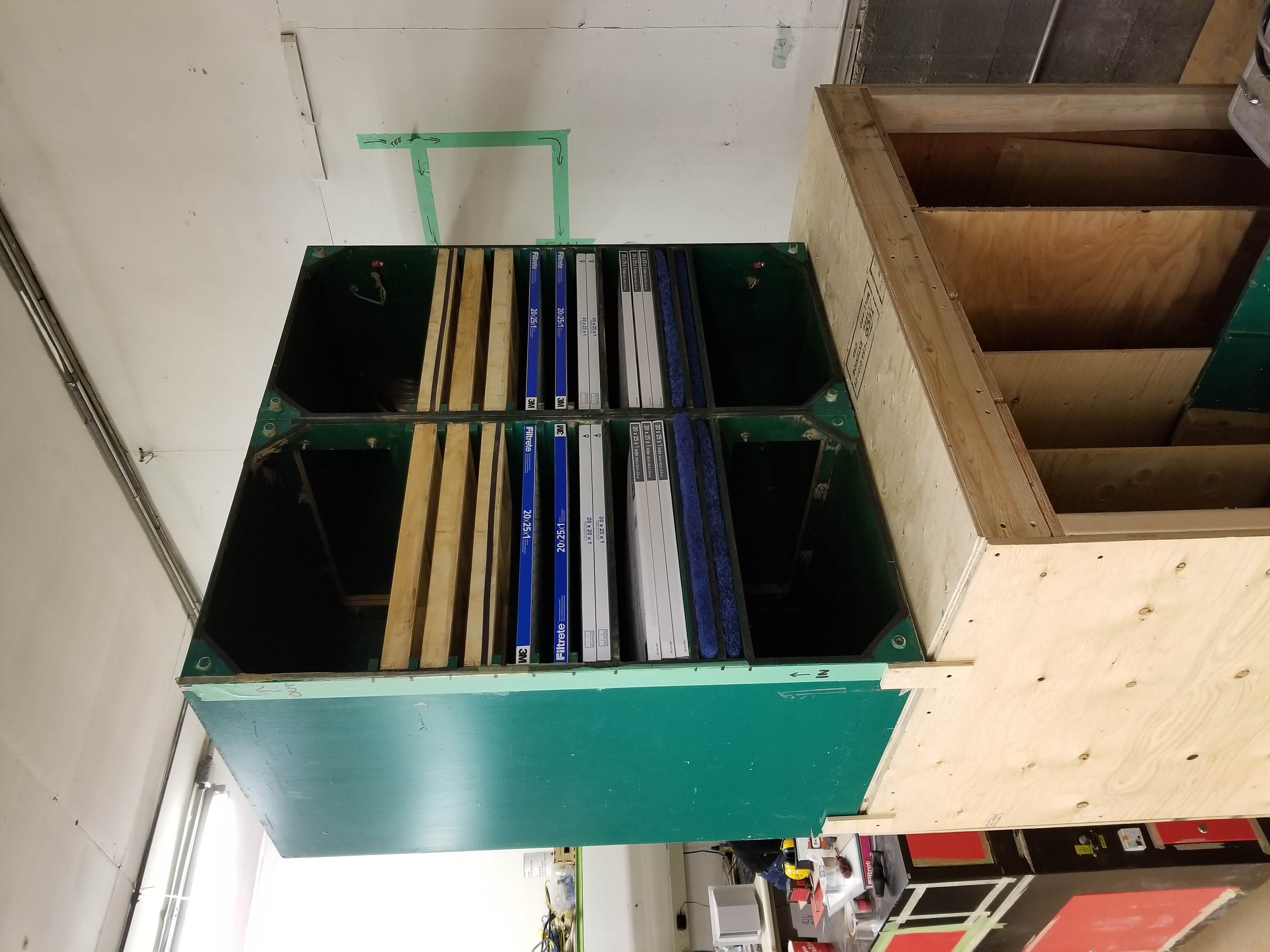

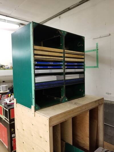

The VHS laser filter system is designed to use standard 20“ x 25” furnace filters in two identical parallel stacks (see photo below). Each stack comprises, from bottom to top:
  • Bottom plenum (i.e., empty space); coarse particulates get deposited here
  • MERV 6 / MPR300 Pre-filter (x3 layers)
  • MERV8 / MPR 600 Furnace filters (one 2“ layer or two 1” layers)
  • MERV11 / MPR 1000 Furnace filters (one 2“ layer or two 1” layers)
  • MERV13 / MPR 1900 Furnace filters (one 2“ layer or two 1” layers)
  • Jacobi Ecosorb GXB or equivalent granular activated carbon, 4mm or 5 mm particle size (x3 layers)
This system is designed to: a) reduce particulate entrapment in the fine particulate phase, b) ensure removal of particulate matter which is roughly similar to tobacco smoke as per literature on laser exhaust, and c) have sufficient residence time of the air in the carbon bed, while not increasing the overall dP of the filter system.

The air in the filter stack moves from bottom to top. All filter elements have an arrow indicating the direction of airflow. When installed correctly, the text on the filter elements will be upside down, as seen in the picture above. Always rely on the direction of the arrow. There are three different types of filter elements, each with different characteristics. It is imperative that they are installed in the correct order. In the current configuration, only L2 filters (the dark blue filters without a paper frame) are washable. If a filter element is replaced, please label it with a date.
