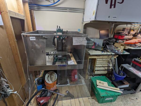

Mill and original stand as donated by Chris:
Jaxen CNC Milling Machine
Pic of Jaxen about 2026 Jan:
