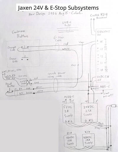

The E-Stop system is simply a normally closed loop circuit that runs from the 24V supply. There are 2 Emergency stop buttons on Jaxen than cut this loop. The loop powers 2 loads: the spindle solid-state power relay, and the input pin for the motion controller to detect if the E-Stop signal is OK.
A future addition could add another relay that kills power to the motor drivers.
