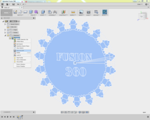

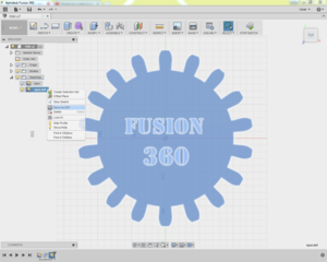

You can export dxf files from any sketch by right-clicking on a completed sketch and selecting 'Save as DXF'.

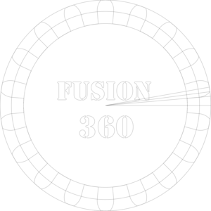

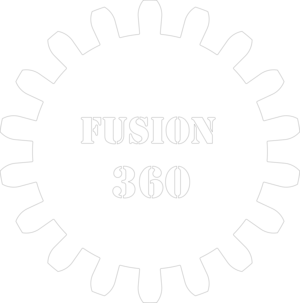

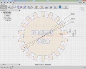

It is a good idea to separate sketches used for design intent with those to be used as cut profiles. When a sketch is saved as a dxf, all of the lines, including and construction lines or duplicate lines, are exported. This can cause problems in the laser cutting software or make it necessary to clean up the file using an intermediate program.
DXF Export Tip
To export a “clean” dxf, create a new sketch on the face you want to cut, then exit the sketch. The sketch will only include the geometry. It can be helpful to rename the sketch as a reminder and then save as a dxf as above.
