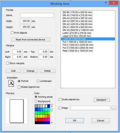

Once you've imported your file according to the steps above,the first thing you'll want to do is to set up your Working Area to understand how your artwork fits on your material.
1.Working Area To do this go to Settings > Working Area on the top menu panel.Once in the pop-out window you can adjust the width and height of the Working area to the required size.

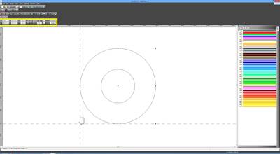

2.Resizing Generally you might need to resize and reposition your artwork. You can do this in the parameters window, see image below.

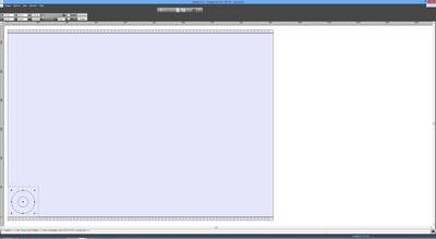

3.Artwork positioning The actual position of your artwork relative to the working area doesn't have any bearing on the final output as the software relocates your artwork to the zero point before outputting. You can check the final position of your artwork in the Preview tool. This is a representation of what will be cut. File>Output>Preview
