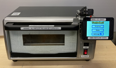

VHS now has a SMD Reflow Oven that is sitting in the soldering section (looking like a mild mannered toaster oven)…
The oven is based the design found here: https://www.whizoo.com/reflowoven
It has recently been upgraded to a new ControLeo3 touch screen controller (https://www.whizoo.com/) that features a touch screen and allows for multiple profiles. This lets you store different profiles for using different types of solder.

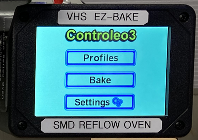

  1. Turn on power using the red POWER switch located on the lower right side of the oven.
  2. The LCD touch screen should show this (if not then hit the HOME icon on the bottom of the screen).

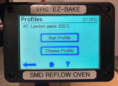

  1. To start baking your PCB select the Profiles button.
  2. Confirm you have the correct profile set (if not then hit the Choose Profile button and use the green arrows to select the desired profile, then use the Back Arrow to return to the above menu).
  1. Open the oven door.
  2. Place your PCB on the metal tray (in the center).
  3. Make sure you are happy with the parts placement.
  4. Slide the tray into the oven.
  5. Close the oven door.

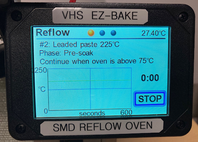

  6. Select the Run Profile button and the oven will start the reflow cycle. The screen will show the progress on a small graph.

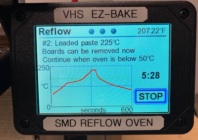

  1. Once the reflow cycle is completed the oven will open the door to allow the oven to cool.
  2. Once the oven has cooled to 100C the oven screen will say it is OK to remove your PCB Note that you need to use tweezers as the boards will be hot… Really really hot… Like burn your friggin fingers even though you should know better hot…
  1. Once the oven has cooled to 50C the oven door closes. This is a better time to remove your PCB.
  1. Close the door and turn off the oven if you are done.
  2. If you have another bake to do then you need to wait till the oven temperature drops to 50C before you can start another bake cycle.

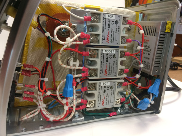

Here are some tech pictures should you have your geek on (and really, why would you be reading a thread on a reflow oven if you didn't)
Inside Wiring:

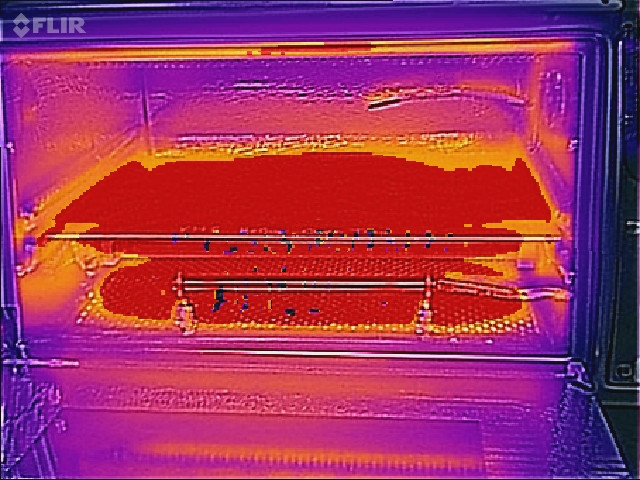

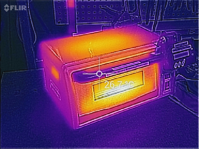

Some IR Views Showing Heat Dissipation (cuz I had access to a FLIR camera)… Front:
Back:
Tray (door was opened after a bake cycle showing pretty even heating):
