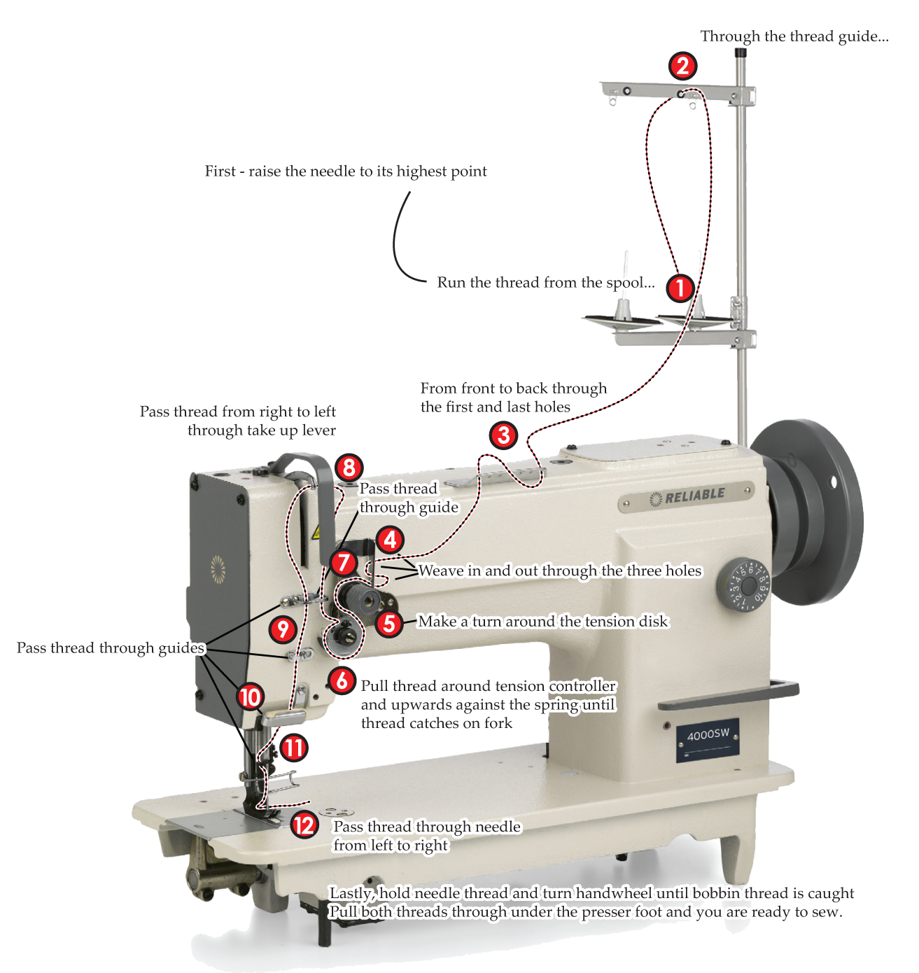

Threading
First turn off the machine!
DO NOT REST YOUR FEET ON THE FOOT PEDAL WHEN THREADING THE MACHINE.
Follow this handy diagram!
