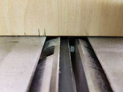

Step 4: Install the jointer blade such that the bevel is on top of the drum. Position the knife hold mechnism (has 4 jack screws) and loosen the jack screws so that the knife and mechanism rest in the drum carriage but not tightly. You should be able to shift the knife and mechanism back and forth with your finger.
Step 5: Measure the straight edge of a piece of plywood with a 1/4“ marking. Position it so that the marking is against the outfeed table's inner edge.
Step 6: With the fence all the way at the back, rotate the drum in the normal direction of travel. The blade should slightly catch the plywood and move it forward. The intention here is to make it move forward only 1/4”. If the plywood does not catch, raise the blade using a hex key on the riser bolt. I found it easiest to get it close to the point where it will catch, then turn the bolt very slightly (1/8 of a turn or so). Keep going until the plywood moves 1/4“. Repeat with the fence all the way at the front.
Once you are happy with where it is, tighten the jack screws. Check again with the plywood to make sure the blade didn't shift while you tightened (it usually does, it can help to hold the blade down with the ends of your fingers on the bevel).
Video showing this procedure
Step 7: Repeat with the other 2 knives.
Step 8: Check again that all knives are still in the correct position.
