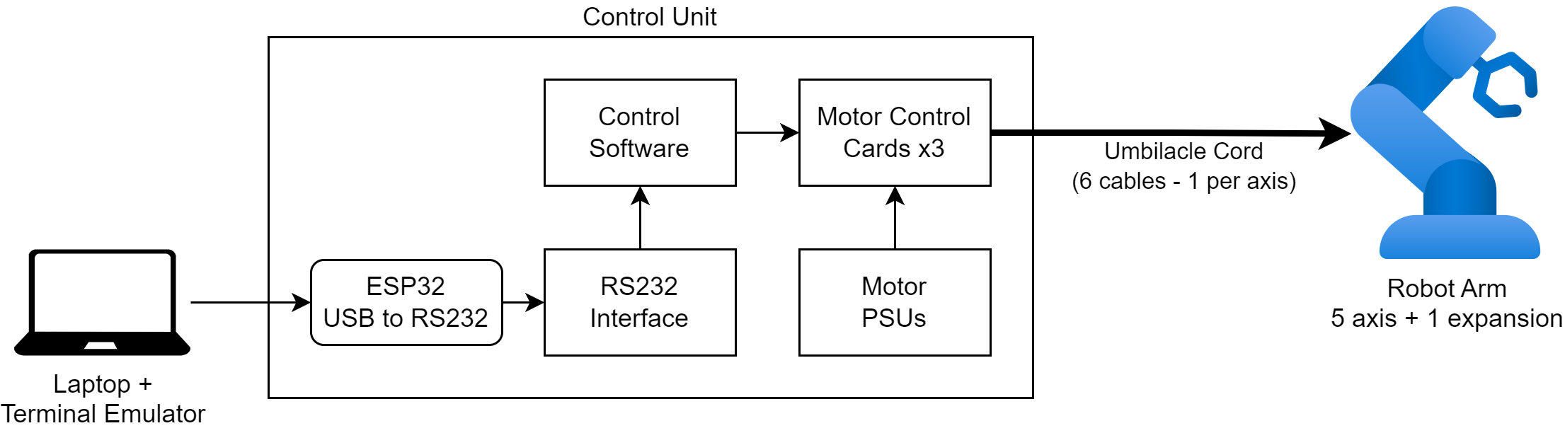

Logical model:
The arm is pretty dumb - it's just motors, encoders and limit switches. All of the power is fed from the control box, and the encoder positioning information is sent back there for processing. Finding and repairing broken wires should be do-able.
I suspect there's broken wires in the arm, or between the arm and the controller. For example, we were seeing no readings from the position encoders on axis 4 + 5, but the motors would still move during homing and test cycles. (As of Apr 2024)
