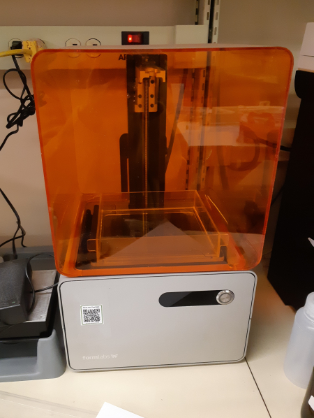

Form 1 SLA Resin 3D Printer
Status Work in Progess
Training Mandatory
Hackable Hardware: No / Software: maybe, see below
If it Breaks Put a “broken” sign on machine, post to Talk with details.
Loan Status Generously donated to VHS
Arrival Date Aug 2018
Location Workbench (designated SLA printing station)
