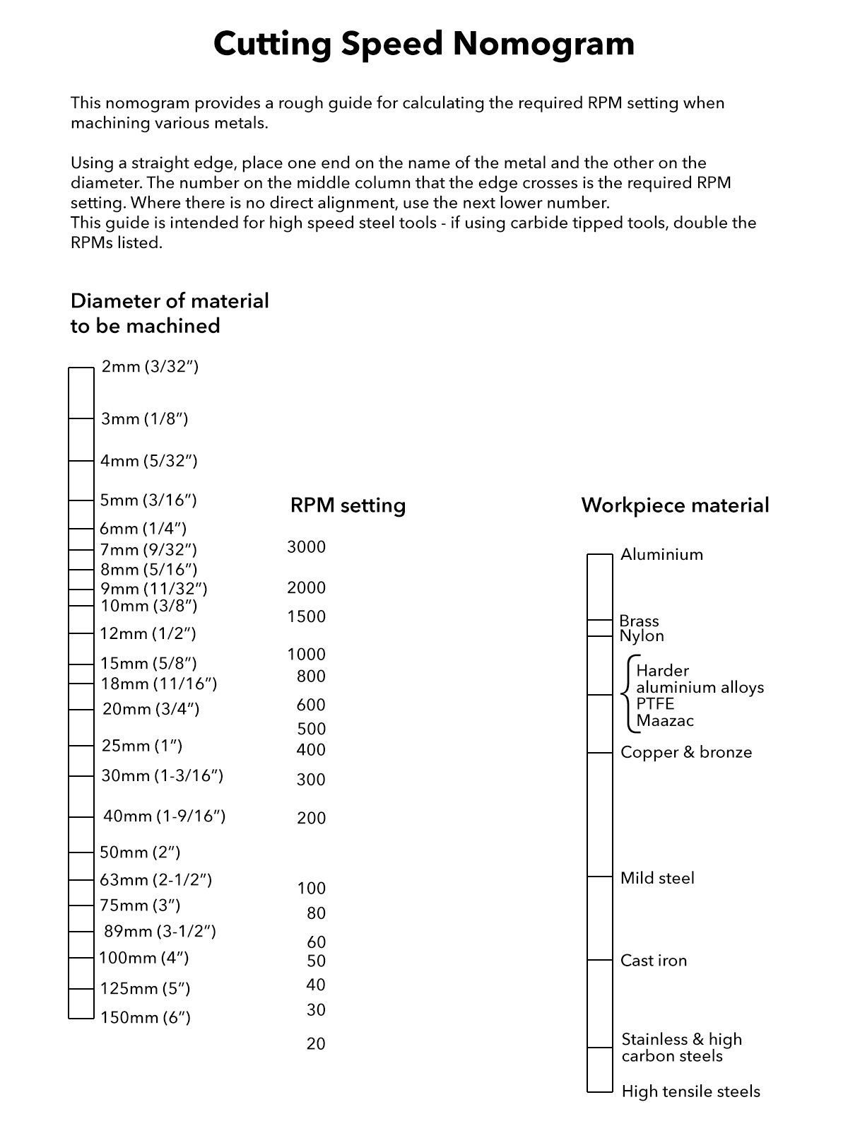

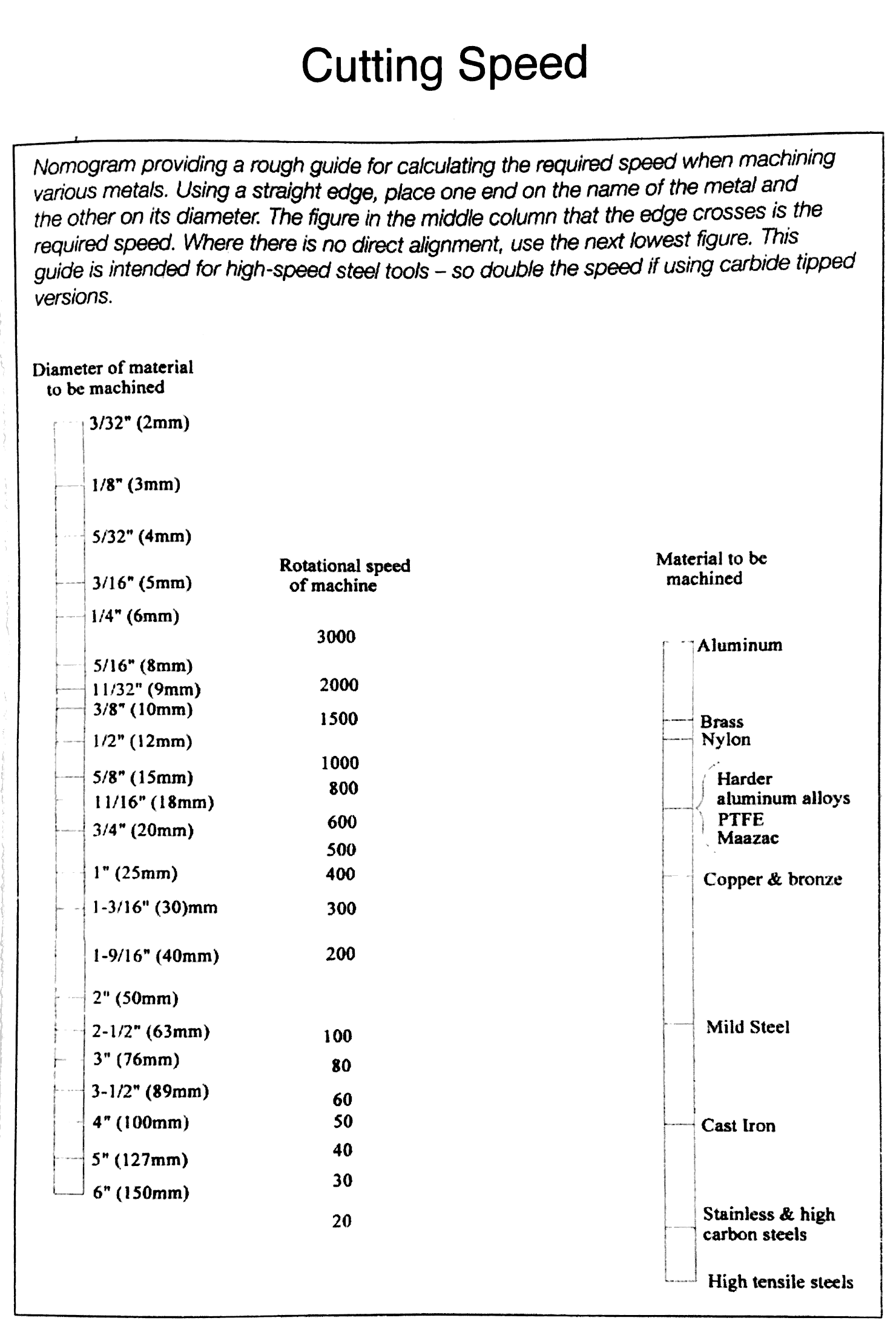

Speeds
RPMs can be determined easily by using this cutting speed nomogram, just substitute the drill size for the workpiece diameter. The original cutting speed nomogram came from Ian at the BCSME.
