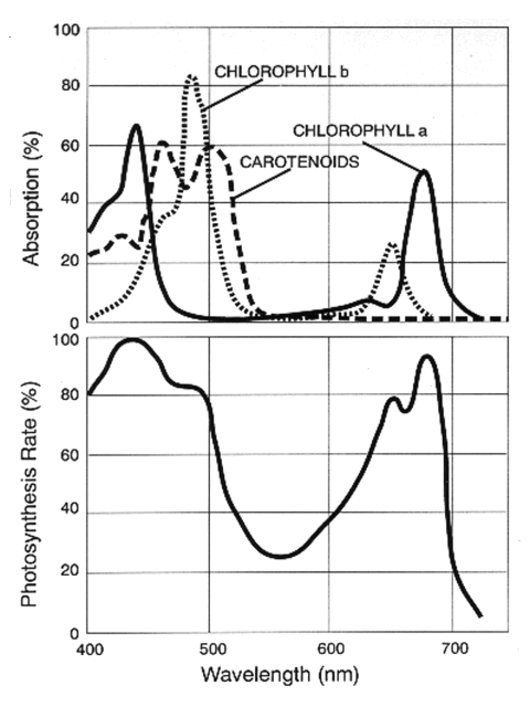

    • light spectrum for photosynthesis is 400nm → 500nm violet, blue light and 650nm → 700nm deep red light
    • With typical RGB only BLUE (480nm) is photosynthetic efficient 624 nm, 540 nm, 480 nm

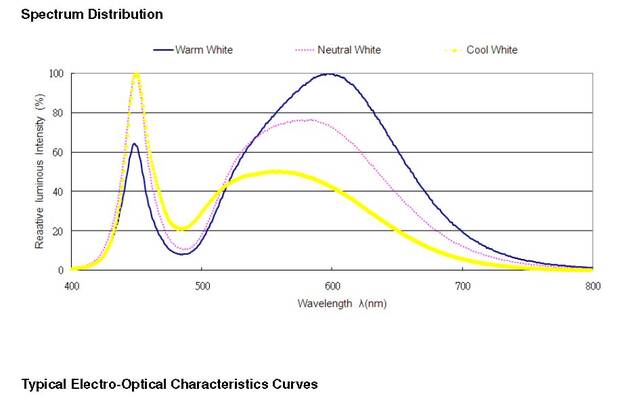

      • can use cool white for the blue light source. 100W Cool White High Power
      • $8.65 100W 32V-34V 3500mA 10000LM
    • white LED colour distribution cool white is by far the best choice if a white LED is used.

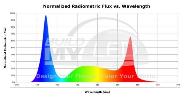

      • 12“ Board: (10) 5700K Cool White, (3) 660nm Deep Red, (2) 450nm Royal Blue

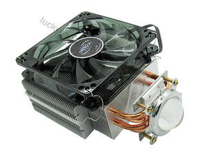

    • chosen solution is to create 300 watt led spot lights
      • 3 (2 cool white, 1 deep red) 10 Degree Cob lens mounted on cpu heat sinks, are conned inwards and shin throw a larger 107mm plano convex lens
      • cooling the 3 x 100 watt cob leds with 140mm case fan blowing air through the spot light can.

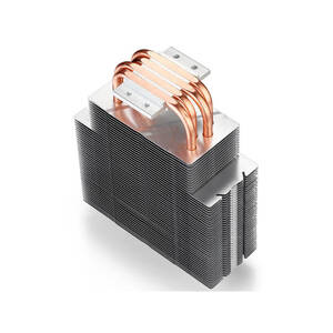

      • $29 USD low cost heatpipe greater than 100 watt cooling capacity
