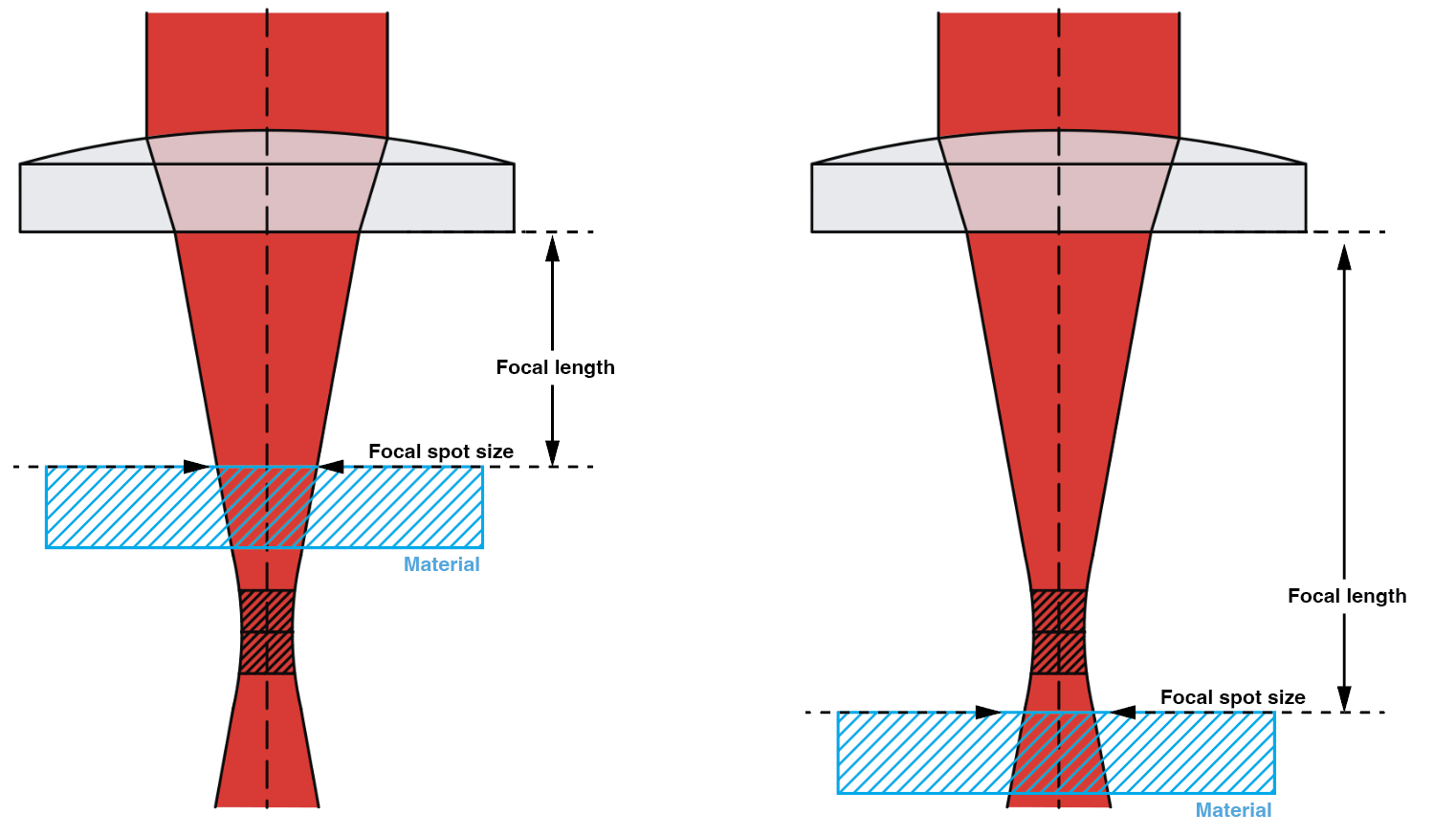

<!DOCTYPE markdown> Understanding laser focus will help you reason about difficulties that you are having with cutting your material. Here is a diagram of a general lens mfor a laser cutter: Laser focus diagram
As the diagram indicates, material surfaces that are placed above or below the focal point will have a larger cutting area than the potential minimum size. A larger area means the same energy is dispersed over a larger area, and therefore may not create as deep of a cut as you are expecting.

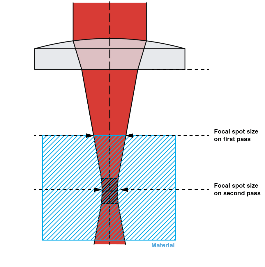

For thicker materials, the focus length problem can become more obvious:
Focus with thick material diagram
